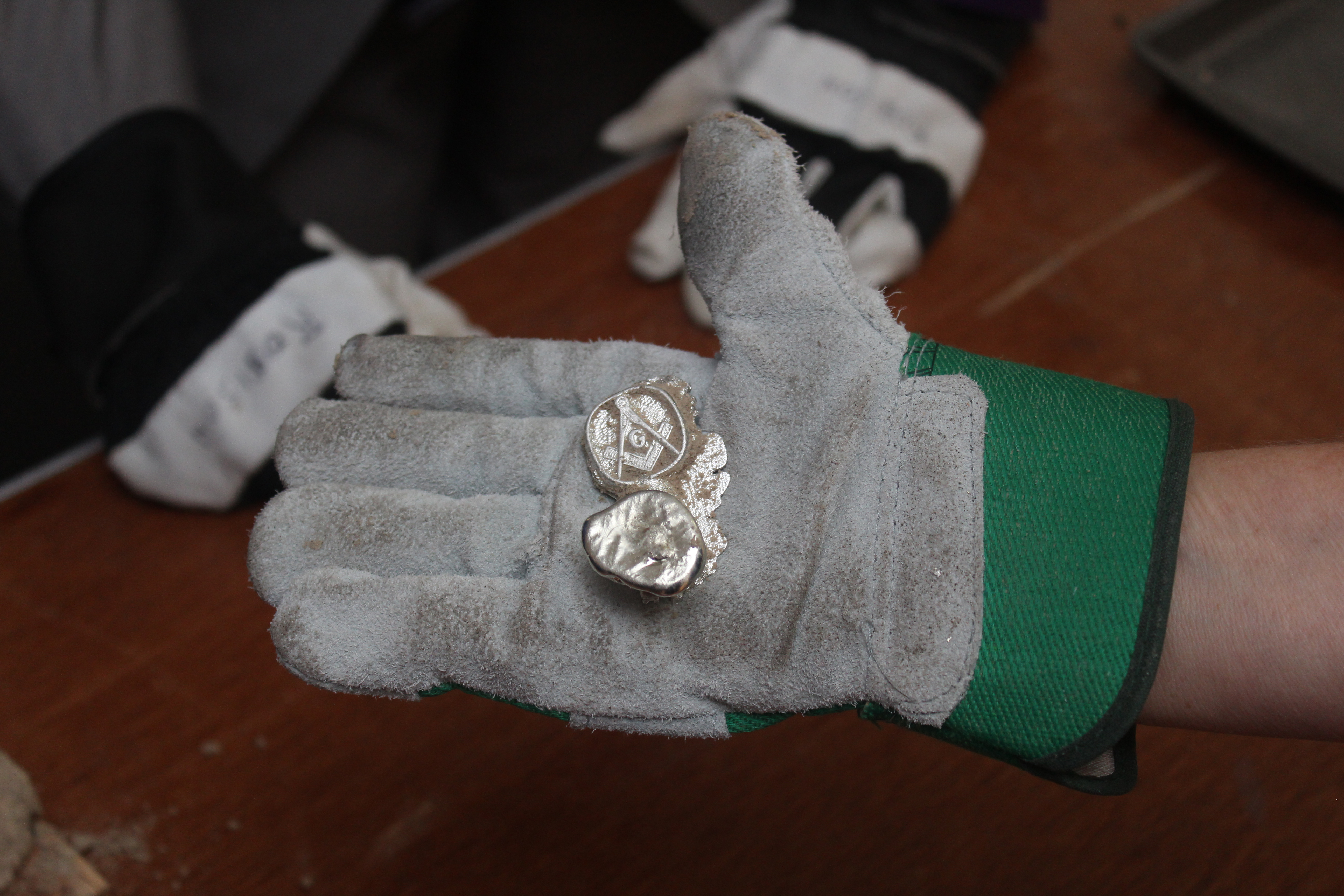

  6. Any excess metal can be cast into the small cast iron cornbread style ingot tray.
    1. CAUTION!! NEVER ADD WET METAL TO LIQUID METAL IN THE CRUCIBLE. This can cause a small steam explosion and it may splash metal out of the pot. Always wear safety glasses.
  7. It takes about 3-5 minutes for the metal in the mold to fully cool and solidify.
 Cleaning & Finishing
  1. After cooling, remove the cope.
  2. Break out the mold over the molding sand container so that you can recover the sand for re-use.Finished casting
  3. Grip the casting by the sprue with the pliers and brush off any excess sand.
  4. Using the snips, cut off the castings and then remelt the gates and sprues.
    1. CAUTION!! Gates and sprues can be remelted, provided they are absolutely dry. Do not put wet sprues and gates back into any remaining liquid in the crucible. An explosion can occur.
All of the metal can be re-melted and all of the sand can be re-used. The sand washes off of your hands with soap and water. Both the sand and the tin metal are non-toxic.
